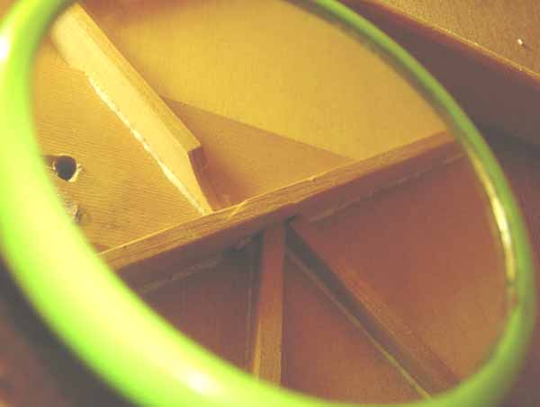

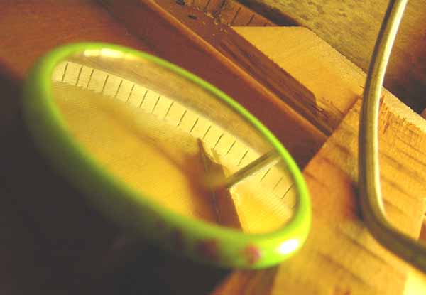

Well ya need special service tools. And number one, (Aside from a small mirror equipped with little blocks glued either side of it's back so it can straddle the back bracings so that you can see that particular part of the top you wish to work on) is a glue application device.

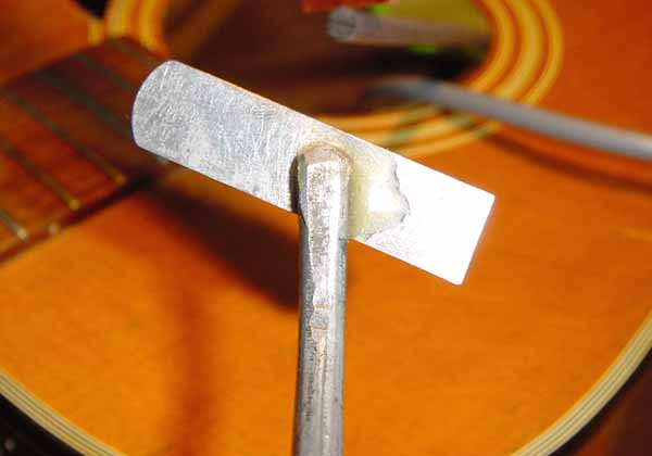

Showing the underside, or that part of the tool that will face down, away from the top of the guitar, this is simply just a piece of feeler gauge epoxied at just THAT angle onto a length of 1/4" mild steel rod flattened at the end and bent just so. These angles are determined via trial and error with inspection light and mirror. For an inspection light, just wire up a small energy saver neon. These run much much cooler than a standard incandescent and the last thing we need is heat building up inside the box softening the good glue which is still holding everything together.

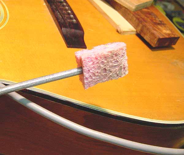

Next, before we apply glue, we need to have ready a clean up device. This one is just another length of 1/4" rod bent just so with a bit of kitchen sponge folded over the end and CA'ed into place.

Once done, you can then apply sufficient glue between the brace and the underside of the top using the rod and feeler gauge tool to deliver the glue into the joint a little at a time. Just be sure to place a bit of paper inside of the guitar to catch any drips from falling on the back before you start.
You then clean up any mess by moistening the clean up tool and scrubbing off the excess glue. Careful not to make the sponge too wet as you do not want to contaminate the glue that you worked into the joint.

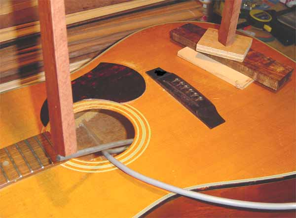

Now you just need to clamp this baby. To do this I used yet another length of rod bent just so. First I supported the outside back of the guitar against downward pressure from the inside. Next I placed a flat piece of wood to span the back braces and spread the load upon which will sit the bottom of the bent clamping rod.
To help counter some of the upward pressure from the top from the clamping rod, I left the top just a little depressed using the small gobar I used to open the glue joint. I then carefully maneuvered the end of the bent clamping rod into position to sit directly onto the brace and then levered the brace upward against the top until I could see good squeeze out (To match the rest of the bracing ).
Once in place, I then used yet another gobar on the end of the clamping rod left poking out of the soundhole to hold it's own spring tension between the gobar, the flat piece of wood which spans the back braces and the other end securing the newly glued brace.
